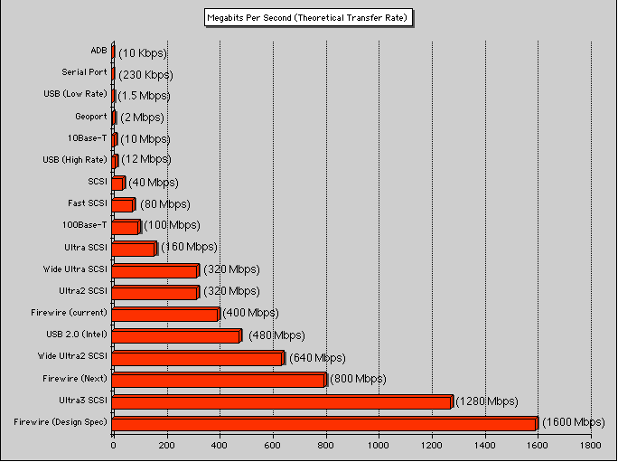

Is Using via USB slow down my Internet Speed?
So it won't reduce your internet speed :)
