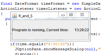

I made a simple reminder and automatic computer shut downer in Java about 2 months ago.
Because I always miss my meals and decide to code an app to prevent that. (But I am not using it much so there is no difference even tough i made it ;) )
I didn't post about this in here because the main code that does the core task of the app, I got it from a website because I couldn't figure it out. I tried with Java API but couldn't. That's why I didn't post my app here. Since I don't like to post a thing that is only half made by me. :( Is it OK to post half work of mine or isn't that a good thing ?
If you can fill me up with that then I can clear my mind about that.
Anyway back to topic. I used Netbens to build this but only used it as the code editor. This has a GUI but I code them all and the other codes all by myself, Only used Netbeans as the code efitor and compiler and runner because it's easy to use and has so many features and even point if I get any errors. Anyway, I didn't even use its code completion because If i do so it's not good because then I'll forget some codes.
Here is what this app does.
Remind the free defined times with messages. In my case.
Breakfast time, Lunch time and Dinner time.
Then shut down the computer.
The code I used that I couldn't find out (I mean the one I got from the internet) is,
The code that gets current system time and then prints it to a JLabel. That's the code I got from the net. And some other too it's the code that uses to shut down the computer.
Anyway, Here is the code. And I am attaching the .jar file too. (If you put this to your start up folder of your Windows computer then this app automatically get started every time you start up your computer.)
Sorry I couldn't add comments to the code because I didn't want to post because as I said half of the code is not mine :cry:

In there what I don't get is how is this working. I understand what these 2 do.
final DateFormat timeFormat = new SimpleDateFormat("HH:mm:ss");
Creates a SimpleDateFormat object but what it does actually? I know it is used to get time but can you explain it in details please?
        ActionListener timerListener = new ActionListener()
I know this one so no need to explain this ;)
Actually in above code I mean the big one, I understand what it does but don't know how those objects get time etc.. Actually I understand most of it but don't know when we want to build a program how me must find suitable codes from the API that's the main problem :?
And the other one is this
Timer timer = new Timer(1000, timerListener);
        // to make sure it doesn't wait one second at the start
        timer.setInitialDelay(0);
        timer.start();
As I said above i have an idea how this works but not a clear idea :?
And another thing, If we get codes from the net and then we make apps isn't that a good thing? I mean because then are we considered as no skilled programers? :? It's a huge problem that is in my mind :(
Thank you for helping me :)

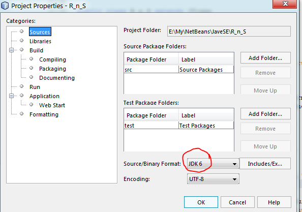

I created a .jar file.it automatically created in %project folder%/dist/R_n_S.jar.but,didn't work when i Launch it.But,in NetbeansIDE it work. :)
I also did this,I think,it changes JRE version.but,not result. :(
