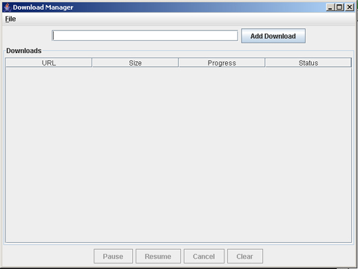

Post by Nipuna » Sun Feb 19, 2012 8:49 am
I haven't tried or read this code, I just though to share this :)
This example shows how to create a simple download manager in Java. It contains four classes in foru Java source files:
Download.java: Contains Download class which downloads a file from a URL.
DownloadManager.java: Contains the main class for download manager application.
DownloadsTableModel.java: Contains the class which manages the download table's data.
ProgressRenderer.java: Contains the class which is responsible to render a JProgressBar in a table cell.
Download.java
