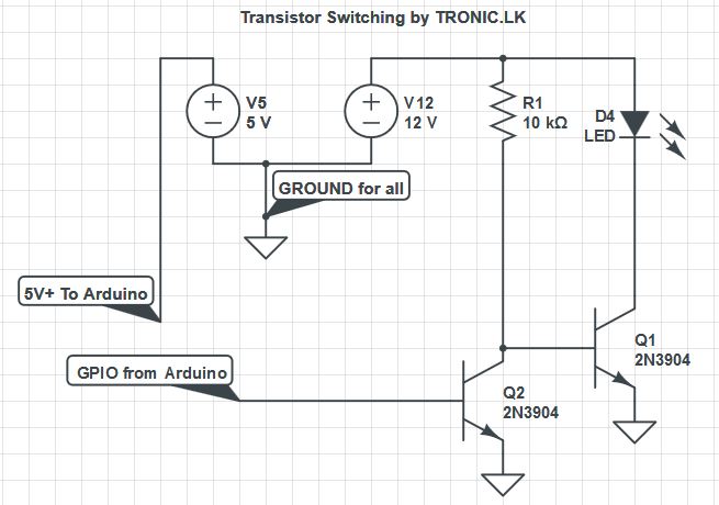

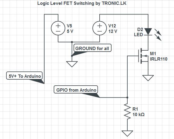

So many people are asking this question, so I thought to create a topic to discuss about this. Here are the diagrams for both options.
NOTE: D4 and D2 LED symbol represent a LED set (series/parallel) which requires 12V.
1. Transistor
2. FET
