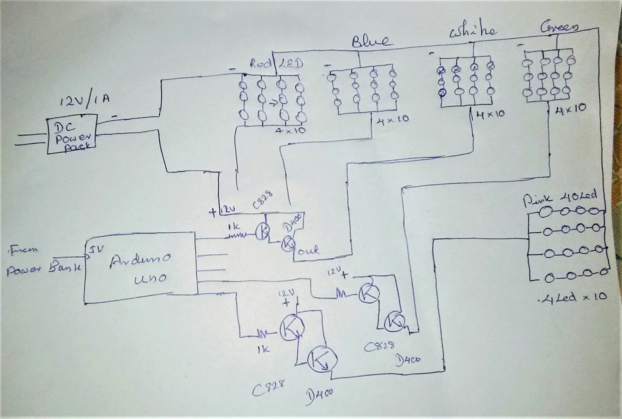

I would like to know how to run 100 LED bulb from Arduno Uno board..
I wrote program to Arduno Uno for get 5 out put from board.
it's working properly. when I connect C828 And D400 Driver cc't to run 100nos led from each channel. but no action from transistor. (Those transistar are new. )
please anyone help me .

Hi Gihan, First I need to understand more about how you have connected the LEDs. Can you post a drawing please. You need to mention input voltage for LEDs as well. I might suggest you to move to a darlington or better to a FET, but before all that, I need the circuit diagram to understand.

Now i'm attaching my diagram

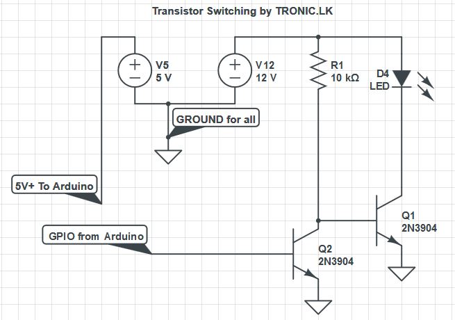

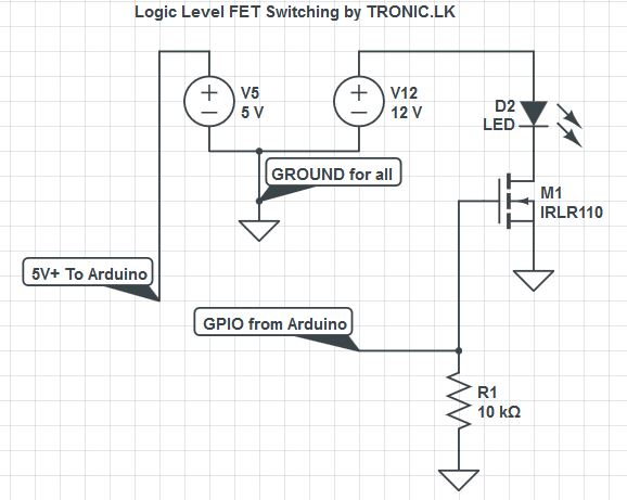

Your digram explains the issue very well. Basically it is not correct. Consider following options. Logic Level FET one is my favourite.
NOTE: D4 and D2 LED symbol represent a LED set (series/parallel) which requires 12V.
1. Transistor switching
2. FET Switching
I used 2N3904, but you can use C828 and D400. Use C828 to connect to Arduino side.
IRLR110 is one of my favourite logic level FETs. I have made it available in TRONIC.LK. You can find it in the following link.

Thanks for advice .
Happy to inform to you I connect 2nos of NOT gate
with Arduno out put and also connected two GND line
together.. It works. but I think D400 is not enough

You better consider using FETs for these high voltage switching purposes. Or else you can use Darlintons such as TIP series.
