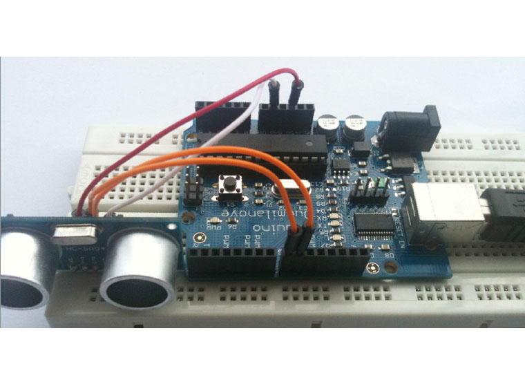

First, it should define two kinds of pins for trigger, 8 for trigger and 9 for echo.

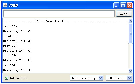

             long distacne_cm = Distance(microseconds, CM); // Calculating the distance
             Serial.print("Distacne_CM = ");
             Serial.println(distacne_cm);   // printf the distance about CM
