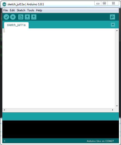

1. Open the application file named Arduino (with blue icon)
2. File >> New ( ctrl + N )

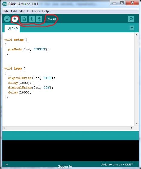

3. Led blinking code
int led = 13;
void setup() {
 pinMode(led, OUTPUT); // initialize the digital pin as an output.
void loop() {
 digitalWrite(led, HIGH); // turn the LED on (HIGH is the voltage level)
 delay(1000); // wait for a second
 digitalWrite(led, LOW); // turn the LED off by making the voltage LOW
This programme turns on an LED on for one second, then off for one second, repeatedly.

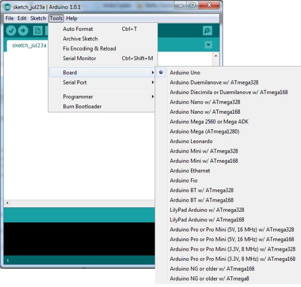

6. Select the model form Tools >> Board

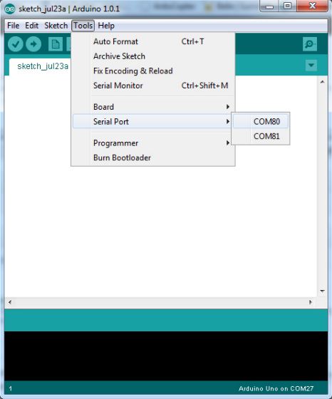

7. Select the port to which your board is connected from Tools >> Serial Port
8. Upload the code to your Arduino
Now the built-in LED will blink as per the given programme. Or you can connect an LED in pin13 – Gnd.
