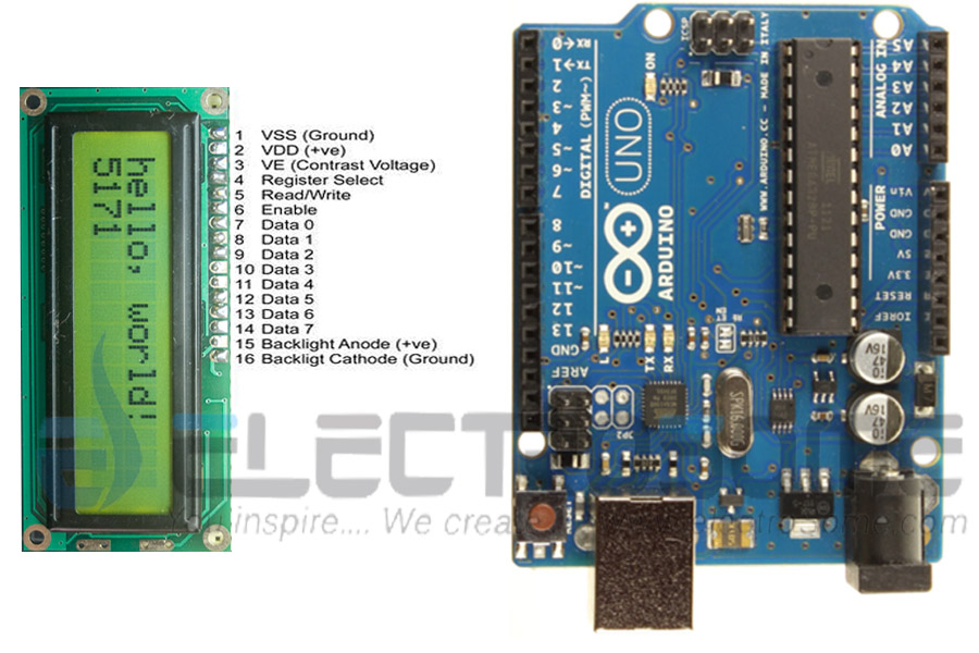

This demo program helps you to interface a 16×2 LCD display with ARDUINO board. This tutorial is provided assuming that you have basic knowledge in ARDUINO programming. If you didn’t have basic idea about ARDUINO programming.
This programmer displays “Hello World!” on the LCD screen and also shows the time.
The circuit connection should be done as mentioned below:
- LCD RS pin to digital pin 9
- LCD Enable pin to digital pin 8
- LCD D4 pin to digital pin 7
- LCD D5 pin to digital pin 6
- LCD D6 pin to digital pin 5
- LCD D7 pin to digital pin 4
- LCD R/W pin to ground
- 10K potentiometer ends to +5V and ground and wiper to LCD VE pin (pin 3)
Diagram :
