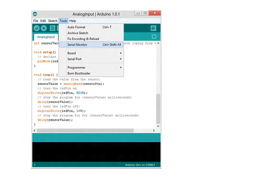

You can see the readings from Serial Monitor. It can be accessed by pressing the shortcut ‘Ctrl+Shift+M’ or you can access it from Tools > serial monitor as shown below.
