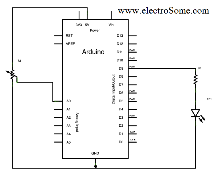

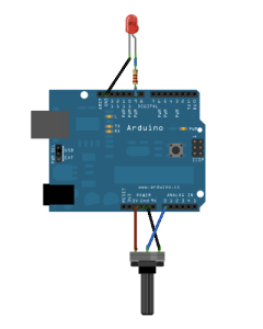

Circuit Diagram
PWM using Arduino Circuit Diagram
- Potentiometer connected to Analog Pin 0
- LED connected from digital pin 9 to ground
