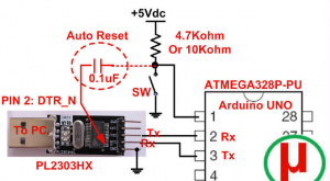

There are two ways to upload a sketch using a PL2003 USB to RS232 adapter, both can be used with gigino board, too.

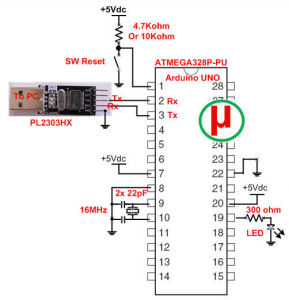

The manual Way
Manual Reset (Press Switch Reset)
  1. Connect the circuit as shown in figure
  2. Install driver for USB TO RS232 and check the number of comport.
  3. At Arduino IDE software
    : Tools>>Board>> Arduino UNO
    : Tools>> Serial Port >> Com X (number on your PC)
  4. Click "Verify button" wait until 'Done compiling'
  5. When you need to upload sketch
    Press Switch reset and hold it, Click "Upload button" and count x seconds (the time up on windows and PC you use, for my testing with XP windows took 3 seconds). After that, Release Switch.
    If you choose the good time for your system, you will see " Done uploading". You are done!!!
    If you quickly or slowly release switch, it cannot upload, you need to try again with the best time for you.

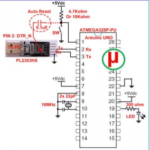

The Automatic Way
Auto Reset (Software Reset)
  1. Connect the circuit as shown in the figure below. (You need to solder the wire from PIN number 2: DTR_N of PL2303 chip and connect to 0.1uF and connect to PIN number 1 of UNO.
  2. You can upload normal sketches automatically.
