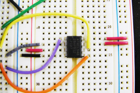

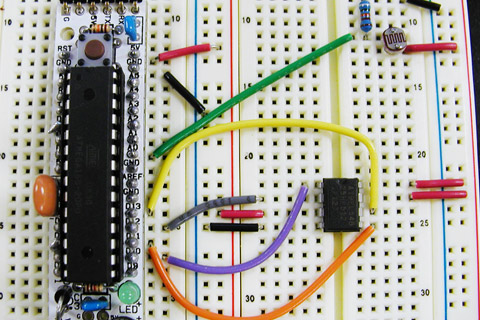

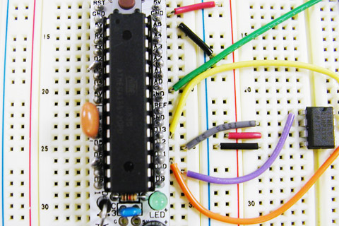

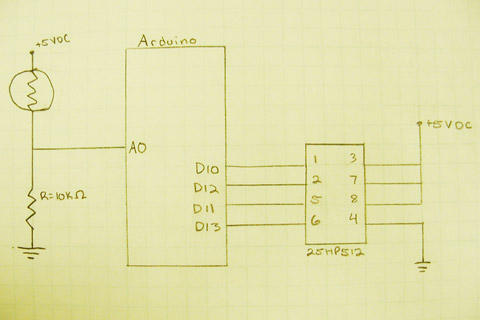

Steps to set up breadboard:
1.) Connect one lead of a CdS Photocell to +5V power. Connect the other lead to a 10k ohm resistor as well as pin A0 of the Arduino. Connect the other lead of the resistor to ground.
2.) Connect pins 3, 7, and 8 of the EEPROM to +5V power. Connect pin 4 to ground.
3.) Connect pin 1 of the EEPROM to pin D10 of the Arduino. This sets up the Slave Select line.
4.) Connect pin 2 of the EEPROM to pin D12 of the Arduino. This sets up the MISO (Master In Slave Out) line.
5.) Connect pin 5 of the EEPROM to pin D11 of the Arduino. This sets up the MOSI (Master Out Slave In) line.
6.) Connect pin 6 of the EEPROM to pin D13 of the Arduino. This sets up the Serial Clock.
