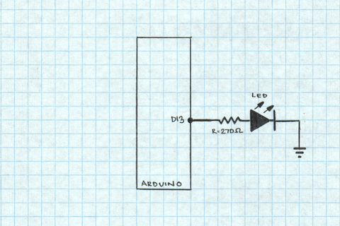

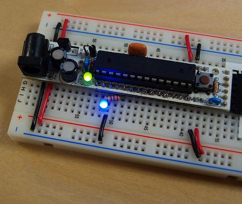

This is the simplest Arduino demo, used to verify that everything is working - and will result in a blinking LED connected to a DIGITAL IN/OUT pin on the Arduino.
When a DIGITAL OUT pin on the Arduino is set HIGH, 5VDC will be sent out on the pin. 5VDC is too much voltage for a typical LED to handle, so a current limiting resistor must be used between the LED and the path to GROUND. A 270 OHM resistor is an appropriate value.
Connect the long lead (the anode) of the LED to the DIGITAL OUT pin on the ARDUINO (In our example, we have chosen to use PIN 13). Connect the short lead (the cathode) to one lead of the 270 OHM resistor. LEDs are polarized components - current can flow through the anode to the cathode, but not in the reverse direction. Connect the other lead of the resistor to GROUND. Resistors are not polarized components - current will flow through them exactly the same regardless of their orientation.
