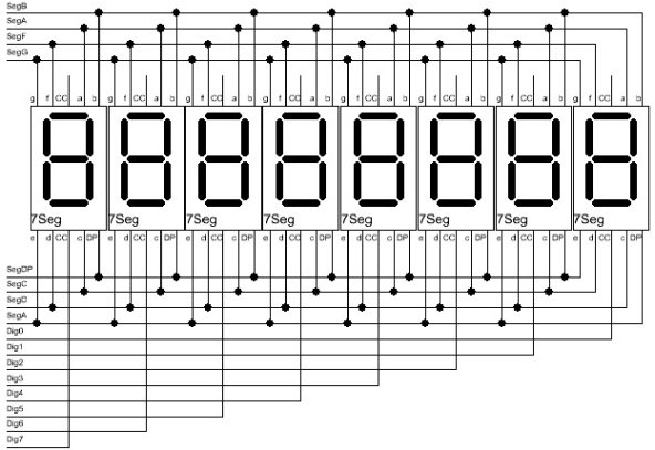

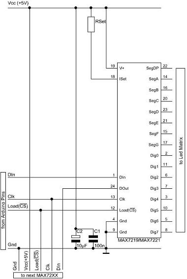

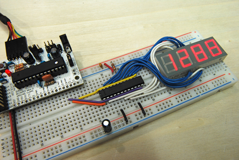

MAX7221 LED driver IC from Maxim is for driving either 64 individual Led's, or up to 8 digits of 7-segment displays. The driver implement a SPI compatible slave interface that can be controlled from the Arduino using only 3 of the digital output pins. An extensive datasheet for the IC is available from the Maxim homepage. Both MAX7219 and MAX7221 are very similar, we will use MAX7221 for the tutorial.

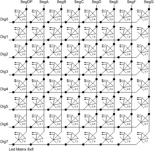

Matrix LED wiring diagram
Courtecy of UMASS AMHERST
