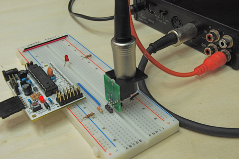

This tutorial explores the basics of MIDI (Musical Instrument Digital Interface) communication. MIDI was developed in early 1980's to be an industry standard protocol to be used for musical instruments, computers and other devices to communicate. MIDI's use has continued to expand and is now used not only as the standard protocol for musical instruments, but for applications such as cell phone ring tones and lighting control systems.
A standard MIDI message (following General MIDI or GM Standard) will contain a Status Byte followed by either one or two Data Bytes (Status, Data 1, Data 2). Following are some of the most common MIDI messages and are the ones used in this example:
note on number channel 1(0x90), note number (0-127), velocity (0-127)
note off number channel 1(0x80), note number (0-127), velocity (0-127)
program change number channel 1(0xC0), instrument number (0-127)

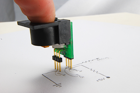

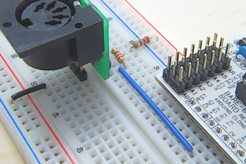

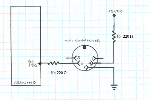

In this example, we connect the MIDI standard 5-Pin DIN connector from our Arduino circuit (MIDI OUT) to the MIDI IN of a standard sound module (we use an Alesis Nanosynth, but any standard MIDI sound module will work.)
