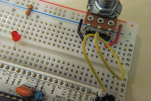

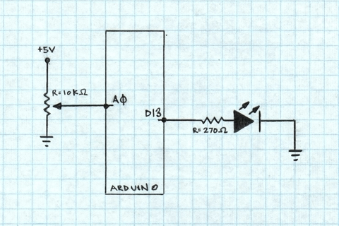

We will connect all three contacts of the POTENTIOMETER to the Arduino. The first connection goes from one of the outer pins of the POTENTIOMETER to GROUND. The second connection goes from the other outer pin of the potentiometer to +5VDC. The final connection is made from the centre pin of the potentiometer to the ANALOG 0 Pin on the Arduino. We also connect an LED with a current limiting resistor to DIGITAL PIN 13 (see LED Blink for reference).
In this example, we've chosen to use a Potentiometer with a male header soldered to the tabs. This creates a very stable and easy to use attachment for the Potentiometer to the breadboard and is recommended, though any Potentiometer chosen will work fine (as long as it is the correct value - 10K OHMS). In the photo below, we see examples of a few different types of potentiometers - the first is a thumbwheel type and will fit directly into the breadboard. The second is the one we are using with the header pins soldered to the tabs. The third is another panel mount Potentiometer with leads soldered to the tabs, which would be plugged into the breadboard. In this example, we are using the Modern Devices Arduino, which has male headers for the 6 Analogue In channels. We are using a lead with one female plug attached to one end to fit into the Analogue 0 pin on the board.
