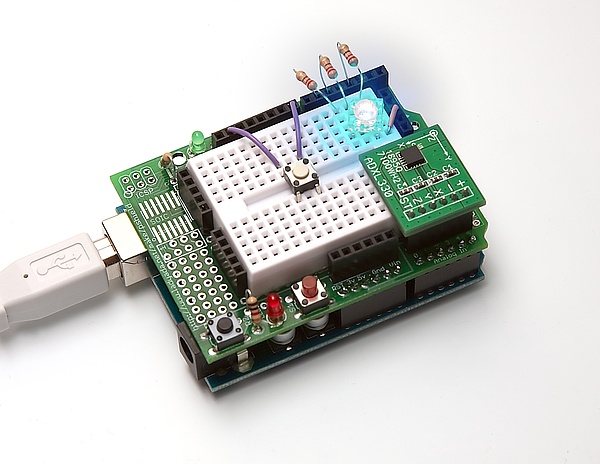

In this circuit, we have connected each of three outputs of the accelerometer to the analogue inputs of the arudino. Each output corresponds to its respective axis and will be converted into a digital number (0-1023). Also, the accelerometer is wired up to a reference voltage (5V) and a common ground. In this code example, we read in the analogue values from each analogue axis-output and subtract a bias value that normalizes the acceleration data. We then perform a simple delta operation that calculates the total change in acceleration and print out all the data using the serial monitor.

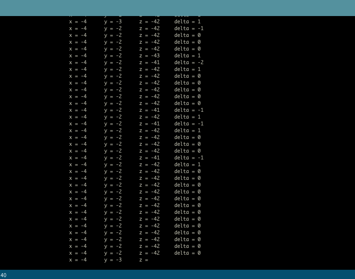

Accelerometer at Rest

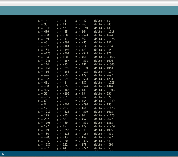

Accelerometer Moving
