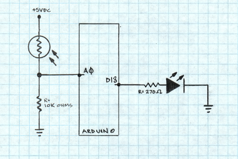

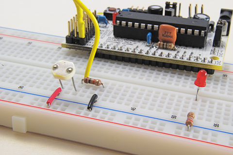

A CdS (Cadmium Sulfide) Cell is a photoresistor whose variable resistance decreases as the intensity of light reaching the cell increases. This component can be used as a sensor to detect light conditions or as a sensor to detect movement - for example, when a constant light is shining on the photocell, a hand can be moving in front of the Cds Cell, creating variations of light intensity striking the cell. The CsC Cell can be used as an analogue input for the Arduino, much like a potentiometer, when a second fixed value resistor is used with the CdS to create a voltage divider. CdS Cells come in many ranges of resistance - the fixed resistor used in this circuit should be chosen to have a value near the upper limit of the CdS Cell's maximum resistance. In this example, our CdS measures a maximum resistance of about 11K Ohms, so we've used a 10K Ohm resistor.
The circuit is very straightforward as can be seen in the image and schematic. One lead of the CdS Cell is connected to an analogue input in the arduino (in our example, we have used A0). Also connected to the Arduino analogue input is the 10K Ohm resistor. The other lead of the resistor is connected to ground. The opposite lead of the CdS Cell is connected to +5VDC.

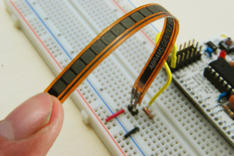

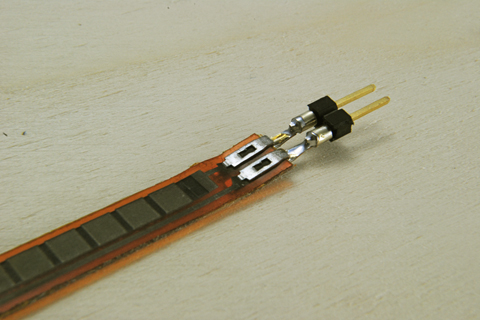

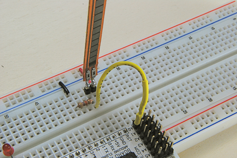

There are many types of analogue sensors available that work on this same principle and can be used in this same way. One common and interesting example is the "flex sensor". Like the CdS Cell, a flex sensor is a variable resistor, though instead of responding to light intensity on its surface, its resistance varies with the amount that the sensor is bent. Also like the CdS cell, a resistor is needed in the circuit to complete the voltage divider. It should be chosen based upon the maximum resistance of the flex sensor - in our case, the same 10K Ohm resistor is an appropriate value. This flex sensor circuit can be run with exactly the same arduino code as for the CdS Cell. The flex sensor can be a very effective way to construct an interactive user interface .
