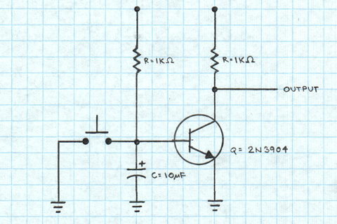

HARDWARE SOLUTION:

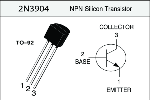

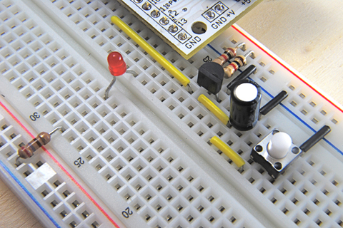

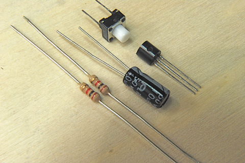

There are countless circuits for debouncing switches - with different methods more or less effective under differing circumstances. The following circuit is one possible solution for switch debouncing and has been chosen for its effectiveness in switching low level logic signals used by microcontrollers (such as the Arduino.) The circuit is very simple and uses a very small number of components (one 2N3904 transistor, one 10uF electrolytic capacitor, two 1K OHM resistors and one N/O momentary pushbutton switch.) In this example, the output of the debounced switch is connected to DIGITAL PIN 8 on the Arduino with and LED connected to PIN 13 (can be used for testing the switch debounce circuit.)
