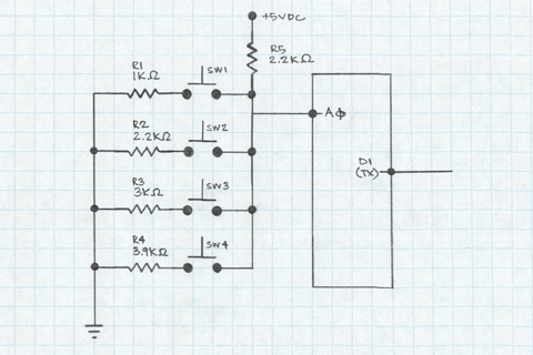

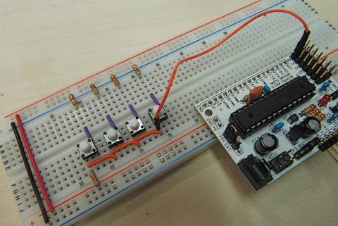

This tutorial uses the same principal of the voltage divider that the potentiometer and analogue sensors are based on. Each of the switches pass through a resistor of a different value to ground, creating a different analogue voltage on input A0. Multiple switches simultaneously pressed creates additional variations in the voltage that appears on pin A0 (1/Rt = 1/R1 + 1/R2 +...+ 1/Rn). This enables the Arduino to determine exactly which switch or combinations of switches are pressed at any one time, creating 15 possible switch combinations. In this example, we used a 1K Ohm resistor on switch 1, a 2.2K Ohm resistor on switch 2, a 3K Ohm resistor on switch 3, and a 3.9K Ohm resistor on switch 4 (these exact resistances must be used for proper functionality). To complete the voltage divider, a 2.2K Ohm resistor connected to the other leg of each switch and the pin A0 on the arduino, with its other leg connected to +5VDC. Resistors of different values can be used - in order to determine the analogue value on pin A0 with each switch and combination of switches, you can use the Serial.print command to see the value in the Arduino serial terminal window.
