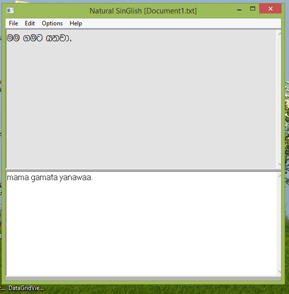

I need a vb net code help as follows.
my form has two text boxes named as Textbox1 & Textbox2. no buttons.
when i type charactor "ga" in english in text box 1
should be display sinhala charactor "?" in text box2
when i type charactor "kra" in english in text box 1
should be display sinhala charactor "????" in text box2
when i type word "gasa" in english letters in text box 1
should be display sinhala word "??" in text box2
I want to be able to type continuously.....like as Singlish....
(sinhala is mothertounge of srilankans)
displaying should be in realtime, I mean without button pressing.
keep a look at screenshot attached.It is a same programme i found..
dears! help me please !
Natural Singlish Screenshot

I went through this in detail. Basically you need to write a English to Sinhala unicode converter. There are several open source (mostly web based) codes available and it will be a good starting point for you.
I found one code written by an undergraduate for a project. You can see that here, http://code.google.com/p/cse-l3-2009-070329e/
The exact code is http://code.google.com/p/cse-l3-2009-07 ... ish.js?r=4
Since it is written in JavaScript, you can easily convert it to any other language. I don't think advance features such as word suggestions are available as in advance Singlish tools like Google Input Tools. You would add them step by step.

I don't think you will find a VB.net code directly for this. In case there is an open source project written in VB.net, Google should mostly expose that. So give try.
With regard to conversion, yes it is not easy to convert a code to another language. The best thing to understand the logic and rewrite it in the language you want. This gives you a clear idea on the logic which you won't get in a direct translation.
