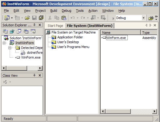

First, select Setup Project, grouped under Setup and Deployment in the Other Project Types section. Choosing this will give you an empty project for adding your deployment units. With the project selected in Solution Explorer, the View->Editor choice gives you a selection that includes File System – this is where you add your files and shortcuts.

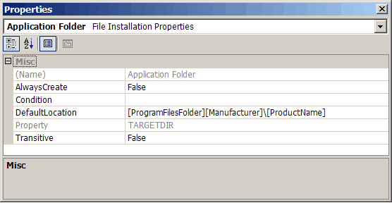

Application Folder is the recommended place to install your programs and other binaries – I’ll explain why in a moment. You can right-click in the Name area and choose Add to browse to your files, or simply drag a file from Windows Explorer. See Figure 1, showing our C# program in the application folder.
Figure1

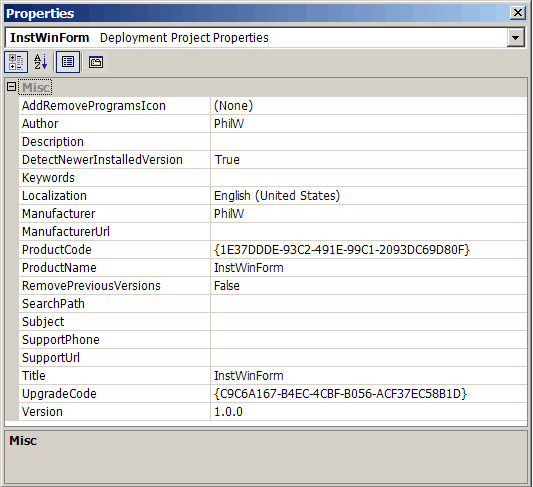

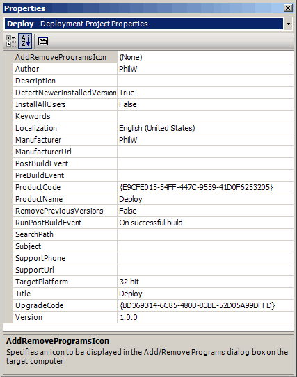

You can see the application folder’s properties by choosing right-click->Properties (or using F4); these properties are shown in Figure 2. Note that the DefaultLocation property is a sequence of names in square brackets. These are not specific properties of Visual Studio setup projects; they are standard properties that apply to any Windows Installer setup.
Figure 2

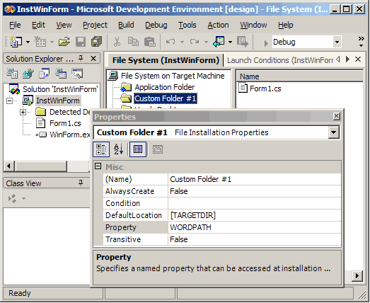

ProgramFilesFolder is the property name for the path to the standard program files folder on the target system—you can’t hard-code something like C:\Program Files because that’s not always the location. The other properties, Manufacturer and ProductName, are also standard Windows Installer properties that you can set as appropriate. (Incidentally, if you’re wondering why there is a backslash after Manufacturer but not after ProgramFilesFolder, it’s because ProgramFilesFolder is a folder property, and these properties already include a trailing backslash.) You set Manufacturer and ProductName in the properties of the project (select the project in Solution Explorer and use F4) as shown in Figure 3. I’ll talk about the other properties there shortly.
Figure 3
Note that Figure 2 shows that the property associated with the application folder is named TARGETDIR. This is another standard Windows Installer property that is most often used for the primary installation folder, as it is used here. The application folder is the usual place to install your binaries because it’s the standard folder location for program files.

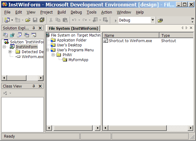

You add a shortcut by selecting your executable in the IDE, right-clicking and choosing Create Shortcut. Visual Studio puts the shortcut in the same location in the IDE (the application folder), but you can then select it and cut and paste it to its required location, such as the User’s Desktop folder (see in Figure 1, center pane).
It’s common practice to add a shortcut into the user’s program menu, and that’s shown in Figure 4. You add your folder names to the program menu by using right-click and choosing Add Folder. Interestingly enough, you can’t use [Manufacturer] and [ProductName] here – they don’t resolve to the actual values at install time as they do when used in the application folder properties.
Figure 4

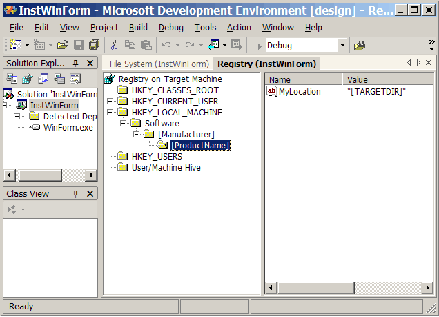

In Figure 2 we saw that TARGETDIR is a Windows Installer property constructed from other installer properties that can be used in square brackets to cause their resolution to actual values during the install. You can use Windows Installer properties like this in other parts of the installation. It’s common, for example, to want to know where the application was installed. Figure 5 shows you how to do this using the registry view in the IDE. In the name of the registry field, you can create a string-valued registry item (MyLocation in this example) that has the value [TARGETDIR]. Note also in Figure 5 the use of installer properties in the registry key folders, used in the same general way as with TARGETDIR and DefaultLocation in Figure 2.
Figure 5

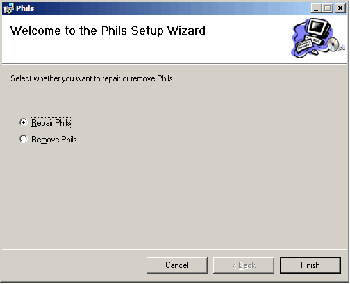

One of the features of a product installed with a Windows Installer setup is its resilience, meaning that it will self-repair if it is damaged by actions such as removing files.
Repair descriptors are created during the install and are associated with certain installed items, including shortcuts. This means that using a shortcut can initiate a health-check of the associated files and restore them if they are missing (and the same repair mechanism can occur to restore registry entries). You can show this quite easily by installing the sample setup and removing the program that is the target of the shortcut (WinForm.exe in this example). If you then use the shortcut referring to the missing file, you’ll see a Windows Installer progress dialog as it repairs the installation by restoring the missing file.
This behavior sometimes takes developers by surprise when they want to install a product and then remove unwanted files or registry entries, so take resilience into account when designing a setup.

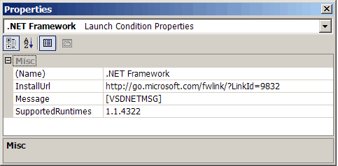

One of the other view options in the Visual Studio IDE is called Launch Conditions. If you look in this view you’ll see that there are two categories shown: Search Target Machine and Launch Conditions. If you look in Launch Conditions for a setup that installs something requiring the .NET framework, you’ll see that Visual Studio has already added a launch condition for the .NET framework. If you look in the properties for this you’ll see something like Figure 6.

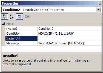

Figure 6
Two interesting items here are the SupportedRuntimes value and the URL. SupportedRuntimes is the .NET Framework runtime version your application uses; this value can be a semi-colon delimited list of the versions your application can use. The InstallUrl is a link to where the framework can be downloaded.
When you run the setup, one of the first things that happens is that Visual Studio runs some code to check for the presence of the framework on the target system. If it’s not there, Visual Studio will offer a yes/no choice for the client to install it from the named InstallUrl. If you look at the documentation for InstallUrl you’ll see that it doesn’t need to be a URL—there are choices for a UNC path or a relative path location that’s useful when installing from a CD.

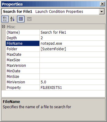

Search for a file
This search is what I call the brute force approach. Figure 7 shows a search for notepad.exe in the SystemFolder. Note those square brackets, meaning that it’s a standard installer property referring to the system folder on the target machine. This search creates a property called FILEEXISTS1 if it’s successful. It’s brute force because it scans the designated folder to the depth required to find that file. Note that the search stops when it finds the first occurrence of the file, so use the date and version specifications to help find the right one in case there are multiple copies of the file.
Figure 7

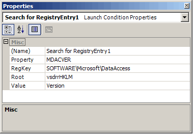

Search for a registry entry
In Figure 8 I’ve created a registry search that returns the version of MDAC (Microsoft Data Access Components) on the target system by reading the registry entry where this value is stored. This time I’ve created a property called MDACVER. There’s a root property where you specify the hive for the search; RegKey names the key and Value names the item you want to retrieve. Leave this value empty if you want the default item from that key.
Figure 8

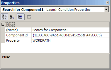

Search for a Windows Installer component
A Windows Installer component is the basic unit of installation in any MSI install. You can’t tell this as you use Visual Studio because it’s generating these components and giving them a GUID when it builds the MSI file, but not exposing them in the IDE. This GUID should not be confused with the ProductCode or UpgradeCode GUIDs. In Figure 9 I’ve created a search for a component GUID that happens to be the value for the WinWord executable from Microsoft Office 2003. I’ll explain how to find values for these GUIDs in a moment.
Figure 9

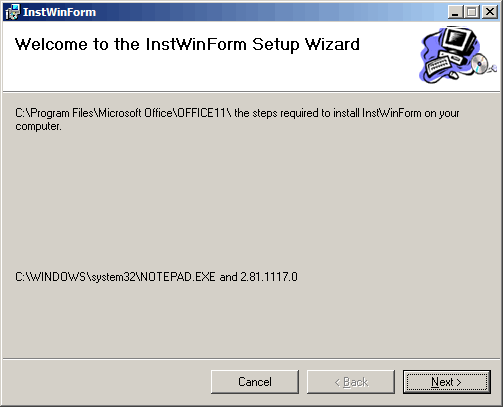

It can be difficult to see the property values that result from these searches when you’re debugging. One way to do this is by showing them in the welcome screen of the setup. This works because these searches take place before this dialog is shown. Looking at Figure 10, you can see I’ve deleted the standard text in the CopyrightWarning and WelcomeText properties of the welcome dialog and partially replaced them with those search properties in square brackets. Note that the standard welcome text includes [ProductName] to show the product name (see Figure 3 to see where you set it).
Figure 10

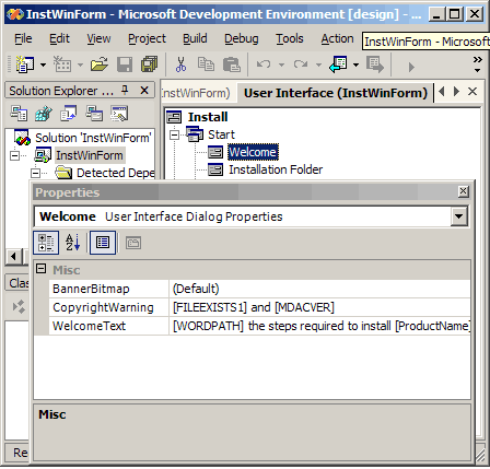

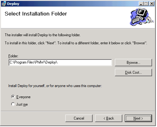

When you run the install, the welcome dialog will show you the property values, as in figure 11. As you can see, the WORDPATH property is the directory where Winword.exe is installed, FILEEXISTS1 is the actual location of Notepad.exe, and MDACVER is the version of the data access components.
Figure 11

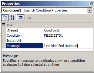

One of the ways you can use the result of a search is in the launch conditions. The property will be created if the search succeeds, but not if it fails. This means that you can use these properties as Boolean values in a launch condition. If you go to the launch conditions node in the IDE and add a condition, you’ll see that there’s a condition drop-down that is pre-filled with the properties named in your searches. Figure 12 shows a condition that depends on the FILEEXISTS1 property. You can use these searches to add your own error message and stop the install if certain conditions are not satisfied.
Figure 12
The property value returned by the Windows Installer component search is a path to that component and its installed location on the system. One of the places you can use a path is when you create a custom folder in the file system view. Figure 13 shows a custom folder that has a property value of WORDPATH so that the file (Form1.cs in this case) installs to the same folder where Winword.exe is installed. If that WORDPATH value is not set, the install defaults to the application folder specified by TARGETDIR in that DefaultLocation property in the IDE.
Figure 13

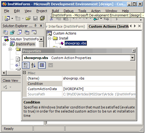

Custom Actions
It’s extremely useful to be able to add your own code to a setup. Windows Installer calls these custom actions, and they are basically functions that are called during the install. I’ll look at a simple one for now, and cover them in detail in a subsequent article.
Perhaps "real programmers" look down on VBScript, but there is excellent support in Windows Installer for calling VBScript code. Figure 16 shows an install custom action configured in the IDE, calling a custom action that is a VBScript consisting of this single line of code:
msgbox Session.Property ("CustomActionData")
Figure 16
As you can see from Figure 16, CustomActionData is being set to our WORDPATH property value (in square brackets so that it’s resolved as a property value). Session.Property in that script is part of the object model framework supplied to the script at run time.

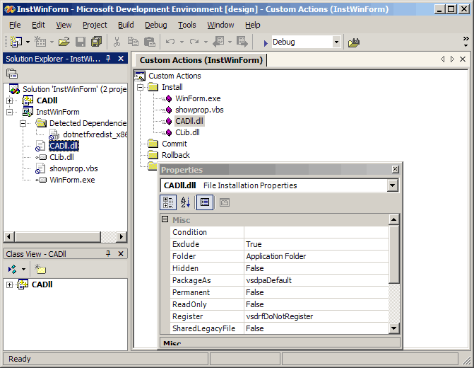

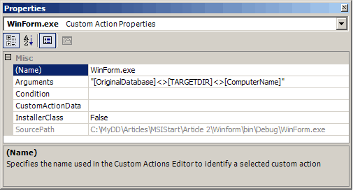

Visual Studio also lets you use an executable as a custom action. You can’t use CustomActionData to pass values to the program, because you’re not passing properties via a call directly from the Windows Installer Service. Instead you can use the arguments value shown in Figure 2, the properties window of a custom action, to call the forms program executable in the sample Visual Studio solution. The argument string is surrounded by quotes so that it gets passed as a single string into the main of the receiving program.
Figure 2
Because this call is synchronous, you can’t use it to launch your application after the install: While the custom-action program is running, the install process waits for it to finish.

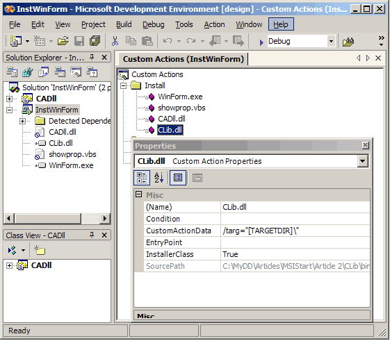

Figure 3

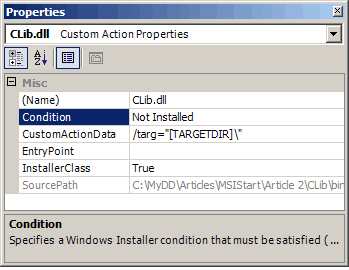

By adding a custom action in the same general way as described earlier, you add these calls as custom actions in your setup project. Figure 3 shows the properties for the custom action. Note that the InstallerClass property is set to True. Figure 3 also shows how to pass CustomActionData into your installer class methods, but it’s not the same format as other custom actions. Here’s a sample CustomActionData string:
/targ="[TARGETDIR]\"
This is the general format required for passing data into installer classes. You must put quotes around Windows Installer folder properties so that the internal parsing works correctly. The parameter string ends up in Context.Parameters of the installer class, an IDictionary object with keys and values, and there will be a key corresponding to your CustomActionData key (targ in the example). This means that there will be a this.Context.Parameters["targ"] key with a value of TARGETDIR resolved to the run-time value.

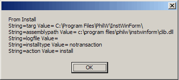

You can enumerate through these context parameters with the following code, which is intended to be called as a debug method passing "Install" as the string parameter if it’s being called from an install custom action:
private void ShowContext(string where)
StringBuilder sb = new StringBuilder();
StringDictionary myStringDictionary = this.Context.Parameters;
sb.Append("From " + where + "\n");
if (this.Context.Parameters.Count > 0)
foreach (string myString in this.Context.Parameters.Keys)
sb.AppendFormat("String={0} Value= {1}\n", myString,
this.Context.Parameters[myString]);
MessageBox.Show(sb.ToString());
This will give you a message display as shown in Figure 4. There is a "targ" key where the value is the install folder TARGETDIR, and there is an assemblypath key with the install path of the assembly. This is a useful alternative to passing TARGETDIR because it tells you the path to the assembly. This is not documented anywhere, so I do not recommend that you rely on it in different versions of Visual Studio, because it’s being passed in as part of the internal implementation of installer classes.

When is my custom action called?
There are no clues in a Visual Studio setup project that tell you when your custom action is called. Before explaining that, however, I’ll describe the three stages of a Windows Installer setup:
A user interface sequence during which data is gathered (file locations, choices and so on) and the system is not being changed.
An auditing sequence in which the actions that will be done are written to an audit file, and the system typically is not yet changed.
An updating sequence in which the audit script is processed and changes are made to the target system.
The reason for the audited nature of the process is apparent if you’ve seen a Windows Installer setup fail and roll back. What’s happening is that the changes made to the system are backed out with the help of that audit script. It’s a feature of a Windows Installer setup that a failure will restore the system as if the install had never started.
Visual Studio custom actions are called during the third stage of the setup. It should be apparent that you can’t use install custom actions in Visual Studio to make significant changes to your setup, because by the time your custom action is called, the install is almost finished and it’s far too late to change something like TARGETDIR. On the other hand, install custom actions are called toward the end of stage 3, and that means that your files, program executables, and data are installed on the target system and you can use them.
If you want to run one of your programs or make modifications to a configuration file, it’s helpful that these files have been installed by the time your install custom action runs. Also, the user interface can be suppressed in a command line install, so it wouldn’t work well to call the custom actions from the user interface sequence.
Custom actions that are called during stage 3 are known as deferred custom actions in Windows Installer, and it’s the internal handling of these custom actions that requires use of CustomActionData to pass data to them. The installation process is actually a client/server environment in which the user interface runs on a user-mode Msiexec.exe and the server installation process runs on the Windows Installer Service Msiexec.exe.
It’s normal to see two or more copies of Msiexec.exe running at the same time because of the client/server architecture, among other factors. During the service part of the installation process, there is limited access to installer properties, and this is why properties are passed to our deferred custom actions using the CustomActionData property.
During stage 2 the CustomActionData values are prepared so they can be used in stage 3. This client/server architecture is also related to property naming. When Visual Studio prompts you for a property name, the names are uppercase. Because Windows Installer properties can be private or public, public properties are denoted with uppercase names. There are two main attributes of public properties that concern us here: They can be passed from the UI sequence to the execution sequences, and they can be specified on a command-line install.
The first attribute is critical when properties are created during something like a Search Target Machine (see the first article in this series). Because Search Target Machine is implemented as a Windows Installer AppSearch action, it will be processed early in the UI sequence (stage 1) or the execute sequence (stage 2), but not in both. So a property that the search creates is public so it can be passed from the UI sequence to the execute sequence.
When you want to do a command-line install and pass in a value for TARGETDIR, for example, use something like this:
Msiexec /i
TARGETDIR=c:\MyFolder
You can’t get a property in VBScript with Session.Property("TARGETDIR") because of the behavior of Visual Studio’s deferred custom actions and CustomActionData. If Visual Studio custom actions were called during stage 2, you would be able to use properties like the one mentioned above, known as immediate custom actions in Windows Installer, but your files wouldn’t yet be installed on the system.
In other words, the Visual Studio design restricts you to custom actions that are called when your files are on the system (deferred custom actions), which means that you must use the CustomActionData property. Other tools that generate MSI files are often more flexible, so if you anticipate complex setups, investigate those tools.
It’s important to understand where your Visual Studio custom actions fit into the installation process and how that affects the kind of thing you can do with them. You should think of Visual Studio install custom actions as occurring after the install.
It’s worth noting that Windows Installer doesn’t know whether a custom action is an install or an uninstall, which is how custom actions appear in the Visual Studio IDE. Visual Studio adds a condition to the custom actions that is true on an install or an uninstall, but you can’t see it in the IDE. If you add your own condition, it’s added to the existing condition with an "and." The importance of this will become apparent when we look at repair in the next section.
Beware of repair
Visual Studio creates a Windows Installer component for each file being installed. When the component is installed, the file is installed. It’s crucial to understand that your custom-action call is internally conditioned on that component being marked for installation, because when a repair occurs the component may be marked for reinstallation. That is, a repair can call your custom action again.
This is easy to see if you install an executable that is the target of a shortcut as well as the subject of an install custom action. If you remove the executable and then use the shortcut, a repair will kick in. The repair will install the component, your custom action will be called, and you’ll see your executable run as a custom action. When you close it down you’ll see it start again as a result of your original shortcut request.
The key point is that your file is reinstalled by the repair. Your custom action, conditioned on the Windows Installer component containing that file, is also being called. You probably expected your custom action to be called only once when your product was installed, but as you see it may be called again. I’ll explain how to fix that in a moment.
Take another look at Figure 1. It shows the CADll custom-action DLL and the VBScript custom action with the Exclude property True in the properties pane in the Solution Explorer pane (note the circle with a line through it in both cases). So the file won’t be installed, as we described in the C++ custom-action DLL. The DLL and the VBScript are packaged separately in the MSI file, streamed out into a temporary location, and run from there.
I just mentioned that an install custom action is conditioned on the component being installed, which is why it also gets called during a repair. But CADll and showprop.vbs aren’t being installed because they’re excluded! So what makes this an install custom action? The internal condition is that the custom action is called if this is not a complete uninstall of the product.
The last key piece of information is that a repair ensures that the entire feature is installed, and Visual Studio setup projects have a single feature. If you look at Figure 1, during a repair the WinForm.exe custom action is called if it is reinstalled, because it’s conditioned on the file/component being marked for installation. Showprop.vbs (and CADll.dll) will also be called because their conditions are based on "this is not an uninstall." So all your custom actions might be called during a repair.
I’ve spent a lot of time on this because it can cause awful problems. You might do a repair from the context menu of an MSI file and your custom actions will run again. If you were creating a database from scratch, that’s a big problem!
The solution is to add an extra condition to the custom actions to prevent them from being called during a repair. The condition is "Not Installed," where "Installed" is a case-sensitive Windows Installer property that’s set if your product is already installed. In other words, during a repair your product is installed and it’s just being repaired, so "Not Installed" ensures that you run your custom actions once during the first install. Figure 5 shows this condition in the custom-action properties.
Figure 5

When you need to build a new version of your setup project or ship fixes to it, it’s tempting to rebuild the project and try to install the MSI file. Doing so, however, typically launches a message box indicating that another version of the product is already installed and directing you to the control panel to uninstall it.
The primary reason for this is that the ProductCode Guid identifies the product to Windows (see the setup project properties in Figure 1). Since you have already installed the product identified by that Guid, you must use a Windows Installer update mechanism to install a new version of your product.
Figure 1
How to update your product

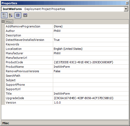

Visual Studio supports the RemovePreviousVersions project property mechanism in its IDE. Figure 1 shows that the value is false. When you’re ready to build a new version of your product to replace an older one, follow these steps:
Increment the version property (see Figure 1). Visual Studio displays a message box that prompts you to change the ProductCode and PackageCode. Select yes.
Set the RemovePreviousVersions property to true.
Setting the RemovePreviousVersions property to true removes previous versions of the product from the system as you install the new version. Since products are identified by the ProductCode Guid, changing the ProductCode creates a new product. That is, the old product is uninstalled as you install a new one. Note that the version property, which becomes the Windows Installer ProductVersion property, is a key piece of data that relates to updating your product. It is not simply a descriptive string.
Figure 1 also shows a DetectNewerInstalledVersion property that checks, at install time, to see that you’re not trying to upgrade an existing installed version with an older version.
Before describing how RemovePreviousVersions works, I’ll explain how PackageCode and ProductCode interact.
PackageCode, ProductCode and repair
The PackageCode is a Guid that uniquely identifies the MSI file from which a product was installed. When you install an MSI file, the PackageCode and ProductCode are recorded on the system. When you attempt to install another MSI file, the PackageCode and ProductCode interact in two ways:
If the new MSI file has the same ProductCode and PackageCode as a product that’s already installed, Windows indicates that you must repair or remove the product (see Figure 2) Remove uninstalls the product, but repair can be more confusing.
Repair does not use your new MSI file to repair the product, nor does it update what you previously installed. Instead, it repairs the existing installed product. That is, it behaves as if you went to the original MSI file used to install the existing product, selected the context menu, and chose repair. (Note: Repair can also be initiated from Add/Remove programs.)
If the new MSI file has the same ProductCode as an installed product but a different PackageCode, you’ll receive a message indicating that another version of the product is already installed.
You cannot set the PackageCode property (Figure 1). Instead, Visual Studio generates a new one when required.
Figure 2
When a product is installed, Windows caches a copy of the MSI file in the Windows\installer folder and records the location from which the MSI was originally installed. The cached MSI file contains the data from the original MSI file but does not contain the actual files, so it can be used to check that the product is installed properly. If there are any missing files, Windows will go to the recorded install location to retrieve the installation MSI file. If a repair is triggered, Windows may ask for the original CD or network location.
The product upgrade
Another Guid, the UpgradeCode, recognizes that a previous version is installed (see Figure 1). When RemovePreviousVersions is set to true, Visual Studio builds an MSI file that checks for other installed products with the same UpgradeCode and uninstalls them. This is known as a Windows Installer major upgrade.
The upgrade uninstalls the older product and then installs the new one, so everything that was installed in the older version will be uninstalled. It does not update files with newer versions. If data files were installed that the user may have updated, they will be uninstalled.
You may need to take this behavior into account when you build the first version of your installation package. It may be better to have your application produce data files at run time, for example, rather than adding them to the setup. This ensures that RemovePreviousVersions will not uninstall them, and they will carry over into the next version of the product.
Everyone or just me?
At install time, the dialog box in which you choose the installation folder is also where you set the "Everyone" or "Just me" radio-button choices (see Figure 3). In Windows Installer terms, it’s a choice between a per-machine install (for all users of the system) or a per-user install (for the installing user). An Everyone install does not upgrade a Just me install, and vice versa.
Figure 3
There is no way to preset the Everyone/Just me setting in Visual Studio 2003’s IDE. Figure 4 shows the properties of a setup project in the Beta 1 version of Visual Studio 2005. Note that there is an InstallAllUsers property to set the default behavior.
Figure 4

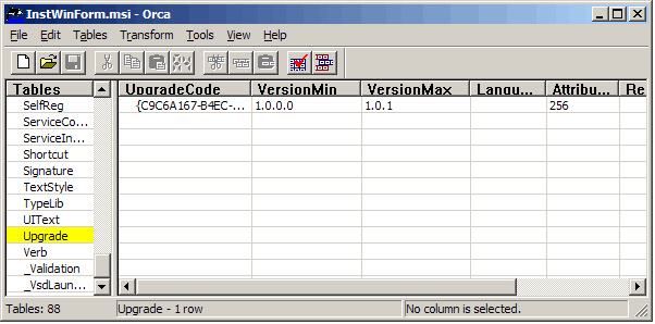

The internal logic that uses UpgradeCode to search for other versions of the product allows a range of version values to be used. A tool called Orca in the Windows Installer section of the Platform SDK can be used to view and edit MSI files. More on this later.
Figure 5shows the values in the Upgrade table in the MSI file. The VersionMin and VersionMax values show the range of values for which to search, but Visual Studio does not allow you to specify this version range, which starts at 1.0.0. If you are partial to versions before 1.0—0.5, for example—your RemovePreviousVersions will fail.
Figure 5
Recall that a Just me install will not upgrade an Everyone install. In Visual Studio .NET, the internal search for a matching UpgradeCode occurs before the per-machine/per-user value is resolved. In Visual Studio setups the default install is per user, so a RemovePreviousVersions upgrade will not upgrade an Everyone per-machine install because it is still in the default per-user mode when it searches for the previously installed versions. Visual Studio 2003 does not have this issue.
