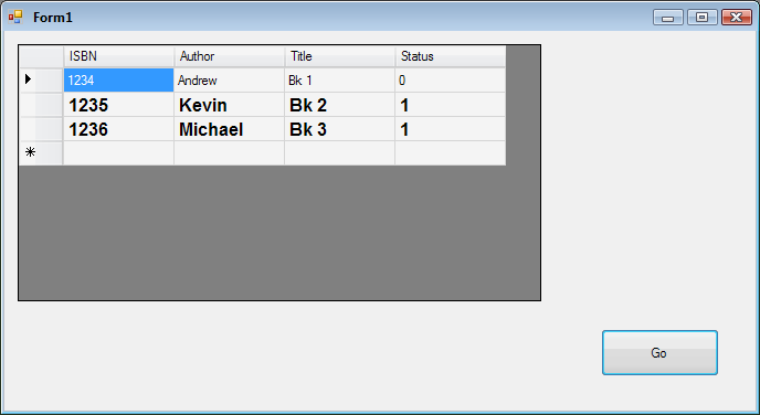

It seems that you have changed the button code to something else. Can you use the one that I have tested with VS.2005 pls.
            foreach (DataGridViewRow r in dataGridView1.Rows)
                if ((Convert.ToInt32(r.Cells[3].Value) == 1)) // change 3 to the index of the selection field
                    //Set Row Font to Bold
                    r.DefaultCellStyle.Font = new Font("Arial", 12, FontStyle.Bold);
Basically you just have to change the column index (in red colour) of line if ((Convert.ToInt32(r.Cells[3].Value) == 1)) to the field index of the table in grid.
